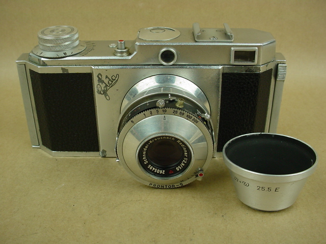

еще одна редкая вещица:
1940s German Rangefinder
Golda : 35mm rangefinder camera
Picture size : 24mm x 36mm
Viewfinder : reverse-Galilean finder
superimposing rangefinder
Focusing : straight helicoid
Shutter : Prontor-S
Shutter speeds : B, 1-1/300sec.
Flash sync contact : X
Film wind : knob
Body dimensions : 132x82x72mm
Body weight : appox. 660g.
