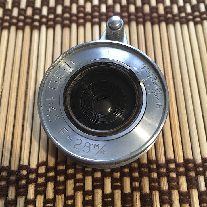

Hi all,
Now I’m dealing with a little lens from FSU, lens elements need a clean and aperture has to be cleaned and lubed back, old dry grease everywhere.
024130E5-EDFC-431F-8704-F3FCB9E810D8.jpeg [ 176.12 КБ | Просмотров: 15308 ]

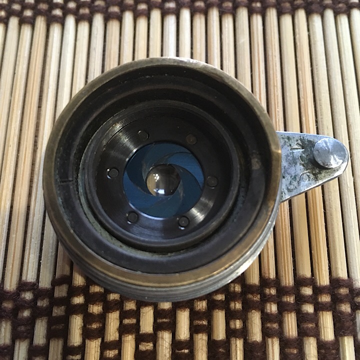

Rear elements came out easily and they are cleaned already.
BA444C1E-C984-4CE1-B8D7-09CCC519C384.jpeg [ 165.19 КБ | Просмотров: 15308 ]

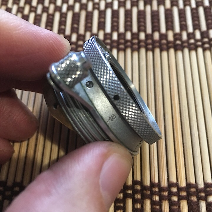

But as usual I’m not good with lenses and I’m stuck to access the front lens the aperture mechanism to be cleaned. There are two screws here - next photo - and a retaining ring as shows the previous photo.
Also another hidden screw which hole is located at the focusing thread...
2019A5AB-7A38-41AD-A23A-89B7FCEE9E75.jpeg [ 139.59 КБ | Просмотров: 15308 ]
Any help how to continue will be appreciated :)

If only the front lens block can come out it will be enough but there are no marks for lens spanner as the rear block, there is thread which suggest that should come out this way... rubber cone and acetone? Anyone has done this lens before?

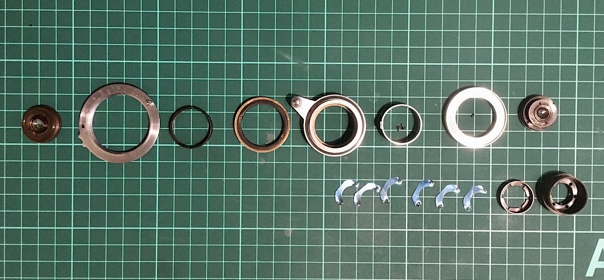

57AB7304-2238-498E-AE52-DCD2A67806EE.jpeg [ 318.76 КБ | Просмотров: 15019 ]
Done! Finally just by myself :)
Lens is mounted back, all lenses surfaces cleaned, aperture tube lubed a bit and two nasty screws head flattened for an smooth aperture movement.
